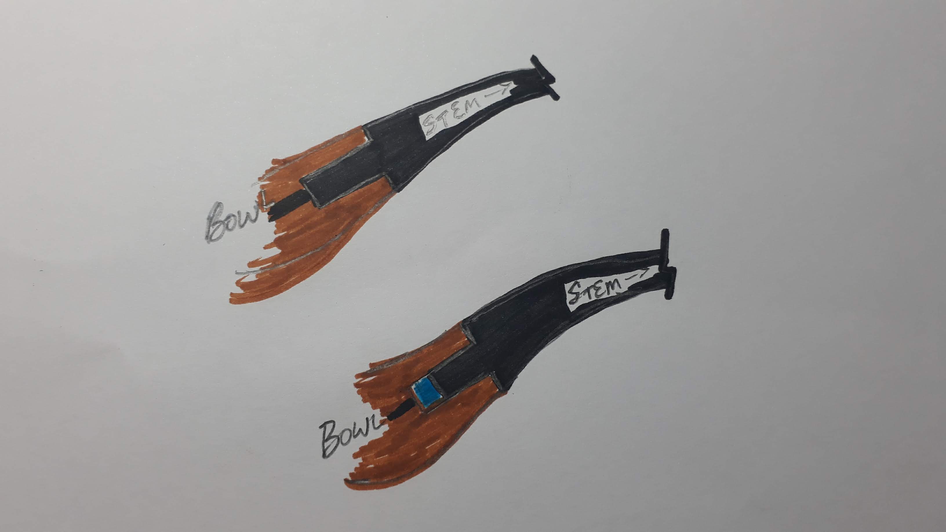

The most common moisture-inducing problem related to drilling is this. If the mortise is deeper than the tenon is long, a plenum (gap) is created (see blue area in the pic below). This pocket of space creates an instant, drastic low-pressure spot in the airway. Even though it's on a tiny scale, it's sudden enough to condense moisture out of the airstream. As this moisture accumulates, it runs back down the shank into the bowl. There's not a lot you can do to help this short of having a new stem made with an appropriately long tenon.
However, you can run a pipe cleaner down the stem throughout the smoke to blot up the moisture.
This is assuming all the other drilling is sound....esoecially the alignment of the airway path between shank and stem. If that's out of whack a pipe cleaner may not go all the way to the bowl. See next post for options on that front....

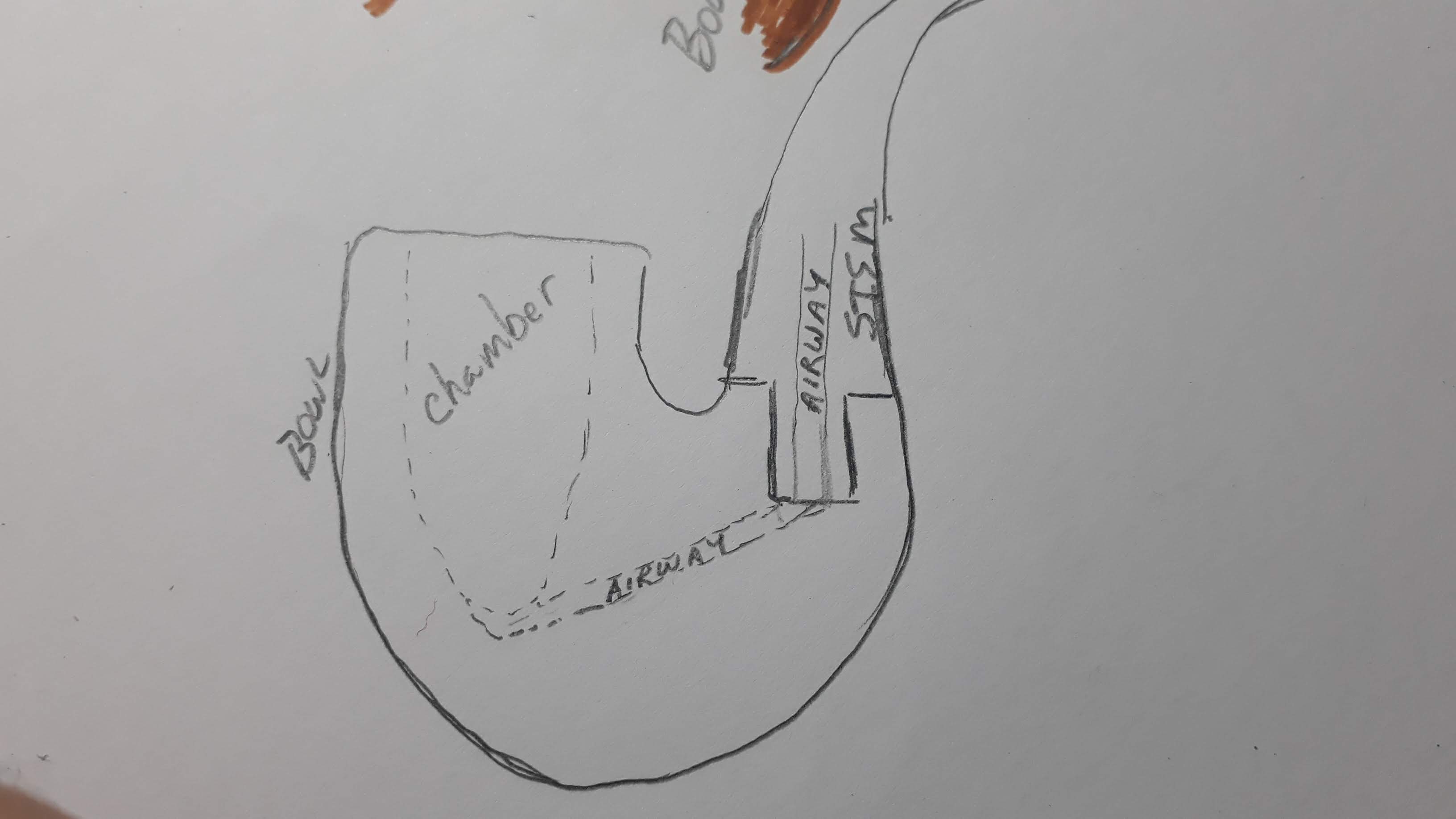

Also problematic is this, and it is especially common on strongly bent pipes (like the exaggerated shape in the pic). Some bends are so aggressive that it's not so easy to drill a hole to connect the stem's airway to the bowl, unless you have one of those fancy flexible drill bits. So, straight lines prevail at the expense of hole alignment. If the airway from the stem is strongly offset from the airway in the shank, a pipe cleaner may not easily pass down to the bowl during a smoke (* - see note below). If you're comfortable doing it, you can take a tiny rat-tail file and try to even them up by tapering each side of the airway (shank and stem). This does run the risk of screwing up your pipe, so it's at your own risk. Think of it as "porting and polishing" your pipe - the same way you'd do the cylinder heads on your car engine.
* - NEVER take your pipe apart hot....it wears out the hole and you'll end up with a loose stem that leaks or falls apart on you. Not good.

Here is probably a better picture of proper draught hole alignment. Notice the ovoid shape of the hole - almost ending in a point rather than an arc - owing to its meeting the bowl perfectly along its floor (the floor of both bowl & draught are on the same level). If the hole enters the bowl at the side of the chamber rather than the floor, you'll probably get a lesser experience and possibly a bad one (constant relights near the end of a bowl, and much more un burned tobacco afterward).
