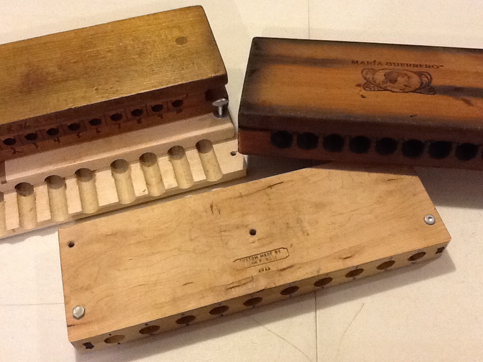

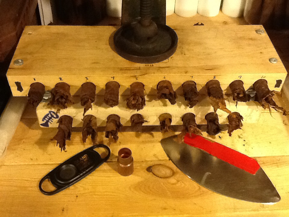

Post by Stewmuse » Fri Aug 01, 2014 6:20 pm
How do cigar rollers get their cigars to be so perfectly straight and round? They use wooden, or now becoming commonplace, plastic molds. A rolled bunch of leaves is placed into a corresponding mold channel. When that row of cigars is full, a top is placed onto the mold. The cigars and molds are then tightly pressed, putting a straight, smooth, and consistent size to each cigar. You do not HAVE to use a mold to roll a cigar, but they will greatly increase your ability to roll attractive, consistent sized cigars.

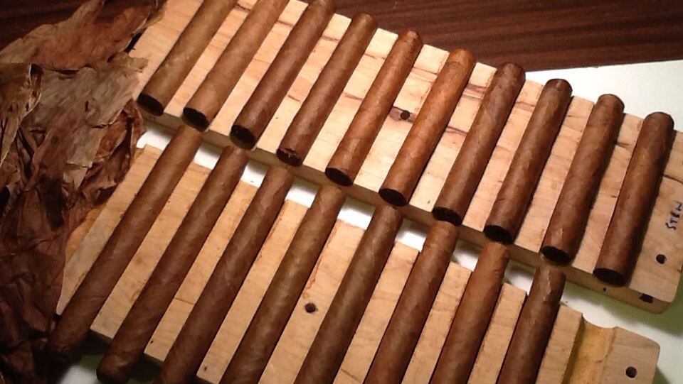

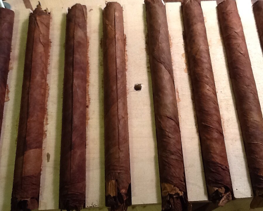

Post by Stewmuse » Sun Aug 03, 2014 3:32 pm
When you put your rolled cigar bunches into a mold and press the two halves together, your leaves will be further compressed. This often results in a narrow crease along each side of the cigar where the mold halves meet. Rollers will, after a period of time in the mold, rotate each cigar 90degrees and then re-press the cigars, thus eliminating the crease. In the photo below, you can see this crease on the cigars on the left, which have already been rotated.

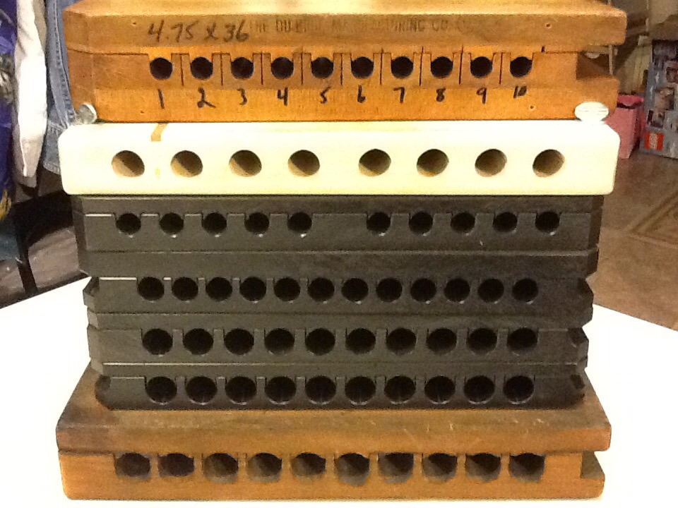

Post by Stewmuse » Mon Nov 10, 2014 11:40 pm
If you are looking for plastic molds, WholeLeafTobacco.com has a few ("slightly used" they say) available on their website at a very good price:
http://www.wholeleaftobacco.com/Profess ... edmlds.htm
They also carry wooden ones, tho their prices are not very good.
