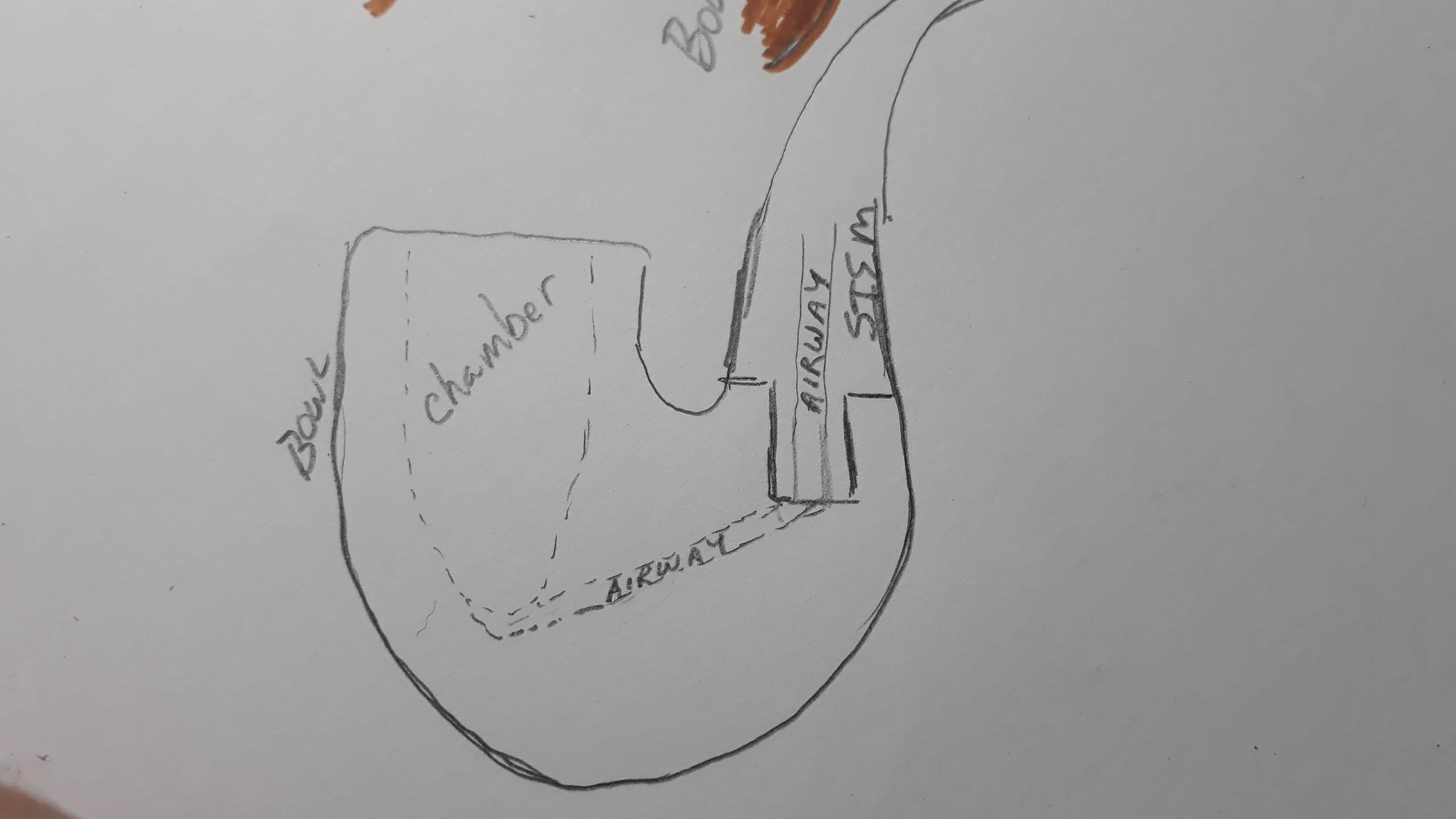

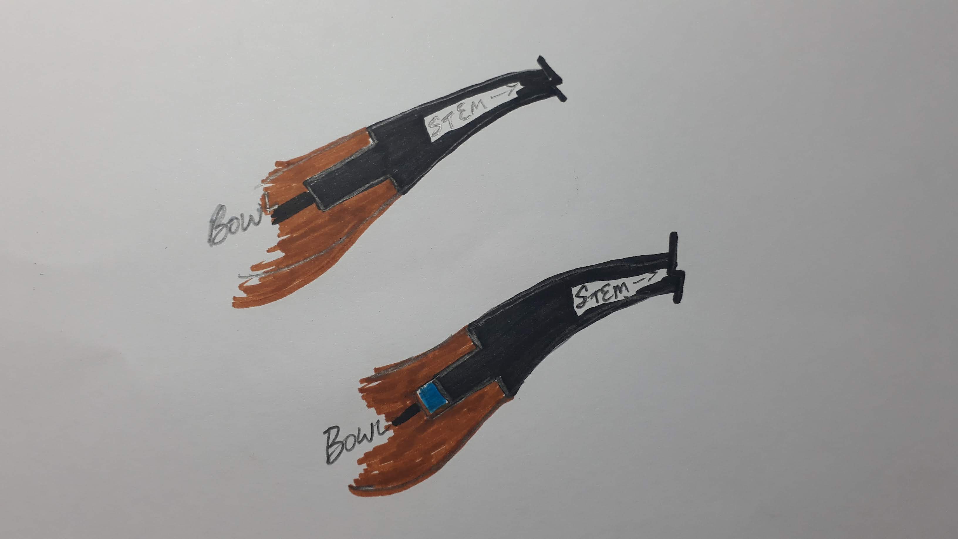

A quickie response to BHH's question in the "What's in your bowl" thread....
The most common moisture-inducing problem related to drilling is this. If the mortise is deeper than the tenon is long, a plenum (gap) is created (see blue area in the pic below). This pocket of space creates an instant, drastic low-pressure spot in the airway. Even though it's on a tiny scale, it's sudden enough to condense moisture out of the airstream. As this moisture accumulates, it runs back down the shank into the bowl. There's not a lot you can do to help this short of having a new stem made with an appropriately long tenon.
However, you can run a pipe cleaner down the stem throughout the smoke to blot up the moisture.
This is assuming all the other drilling is sound....esoecially the alignment of the airway path between shank and stem. If that's out of whack a pipe cleaner may not go all the way to the bowl. See next post for options on that front....
Re: Drilling
Posted: Thu Jun 07, 2018 1:33 pm
by Kip
Also problematic is this, and it is especially common on strongly bent pipes (like the exaggerated shape in the pic). Some bends are so aggressive that it's not so easy to drill a hole to connect the stem's airway to the bowl, unless you have one of those fancy flexible drill bits. So, straight lines prevail at the expense of hole alignment. If the airway from the stem is strongly offset from the airway in the shank, a pipe cleaner may not easily pass down to the bowl during a smoke (* - see note below). If you're comfortable doing it, you can take a tiny rat-tail file and try to even them up by tapering each side of the airway (shank and stem). This does run the risk of screwing up your pipe, so it's at your own risk. Think of it as "porting and polishing" your pipe - the same way you'd do the cylinder heads on your car engine.
* - NEVER take your pipe apart hot....it wears out the hole and you'll end up with a loose stem that leaks or falls apart on you. Not good.
Re: Drilling
Posted: Thu Jun 07, 2018 3:40 pm
by BowhuntnHoosier
As you stated I have been running a pipe cleaner down the pipe during smoking. Everything seems to line up just fine. So it might just be the length of the tenon. Not a real horrible problem just uses two or three cleaners during a bowl. Thanks for the explanation Kip. I have ordered a couple more Savinelli pipes and we will see if they have an issue probably next week. Have a great day and thanks again.
