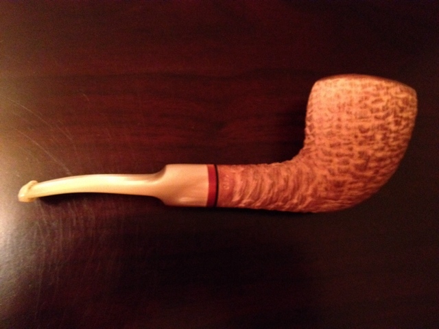

Post by Steve D. » Fri Aug 01, 2014 9:40 pm
Kip, thanks for your detailed response. I investigated the pipe and must say, Bingo!
The shank is bored ~5/16 diameter and ~1" deep and then ~3/64" diameter to bowl. The tenon measures ~5/16 diameter and ~3/4" long and bored slightly larger than 1/16, so you are correct that there is a 1/4" long x ~5/16" diameter area that abruptly increases then decreases in diameter.
May I say, you know your pipes. The pipe is a $70ish Cassano Mare pipe. Disappointing that $70 does not get you s better pipe.
I see three options and would appreciate you opinion:
1) cut 1/4" off the shank
2) replace the stem with one that has a longer tenon
3) fill the void with a piece of wood or plastic
4) insert a short length of stainless steel tubing metal bridge big gap between the draft hole and the tenon
Thanks as always. Off to enjoy a diesel unlimited without tongue bite!

Post by Kip » Mon Aug 11, 2014 7:57 pm
Steve D. wrote:there is a 1/4" long x ~5/16" diameter area that abruptly increases then decreases in diameter.
Wait! Before you do any of those things...unless you're a Norm Abram type woodworker, be very careful doing ANY of those things by yourself. Let's look at them one at a time:
1.) = Not usually a good idea; it's dang near impossible to ever get the face of the shank end to mate properly with the corresponding face of the stem. If you don't care what it looks like, and never intend on selling the pipe you might do this.
2.) This is possible, but you'll need to find someone who does this kind of work that might have one lying around. Both the guys I've used in the past are out of the business now. I don't know who is still around, but I know there are a few.
3.) Possible, but be sure you don't introduce something to the pipe that will release/produce off flavors or toxic fumes when heated...and if it's not a perfect fit you'll still have problems with the pipe.
4.) This is doable, but you'll have to be pretty handy with fine metalsmithing to get a good fit.
May I suggest something else to try first? You can sometimes take a rat-tail file and work on the opening in the stem (NOT where you mouth goes....the end that goes into the pipe shank). Make it as tapered as possible without compromising the integrity of the stem. Usually, a slower, more gradual slope going into the stem is enough to reduce the condensation. The occasional pipecleaner run from button (where your mouth goes) to heel (bottom of the bowl) is often enough to clear out the remaining moisture. This assumes your drilling is otherwise good and you can pass a pipecleaner through the length of the pipe....
Some pipes respond to this, and others don't.........but you now know what to look for the next time you're buying a pipe :)

I located some Delrin stock and read forums out there about tenon repair, but unsure if it is easy to know if it is safe for pipe construction. I am rethinking.
I am curious about your take on the various 'plastics' and materials used for stems. Are they really stable at pipe temps? I taste what I describe as a plasticky taste when smoking the various low end pipes I've tried. Could I be sensitive to the acrylic stems?
I also saw recommendations for epoxy and that just seems crazy to me. I worry about plastic in the beer brewing process and that is at room temp.
Time to invest in a file set, I think. Worth a try.
Thanks for the advice for a newbe.
Re: Pipe Questions
Post by Kip » Wed Aug 13, 2014 12:49 am
Delrín is fine. It's used frequently for tenon repair (tenons break easily if dropped). Acrylic should not be an issue, either. The taste you describe may come vulcanite. It's the most common stem material. It's no issue for allergy, etc. - BUT, being vulcanized rubber, it will oxidize over time. This brings sulfur to the surface, and can give it a weird taste. A buffing wheel or Magic Eraser can restore it pretty well and get rid of that taste.
Some people also experience a weird plastic flavor from tobacco that is heavily Laden with PG (propylene glycol). PG is food grade and safe, but may taste odd and create excess moisture in your pipe (which leads to other issues, so he as tongue bite)
Re: Pipe Questions
Post by Kip » Wed Aug 13, 2014 12:51 am
The picture you provided is acrylic, BTW. It is very durable, and should be flavor free. Sometimes to compensate for its brittle tendencies, the button is oversized, which can be a bit clunky to clench in your mouth. Same stuff bowling balls are made from.
